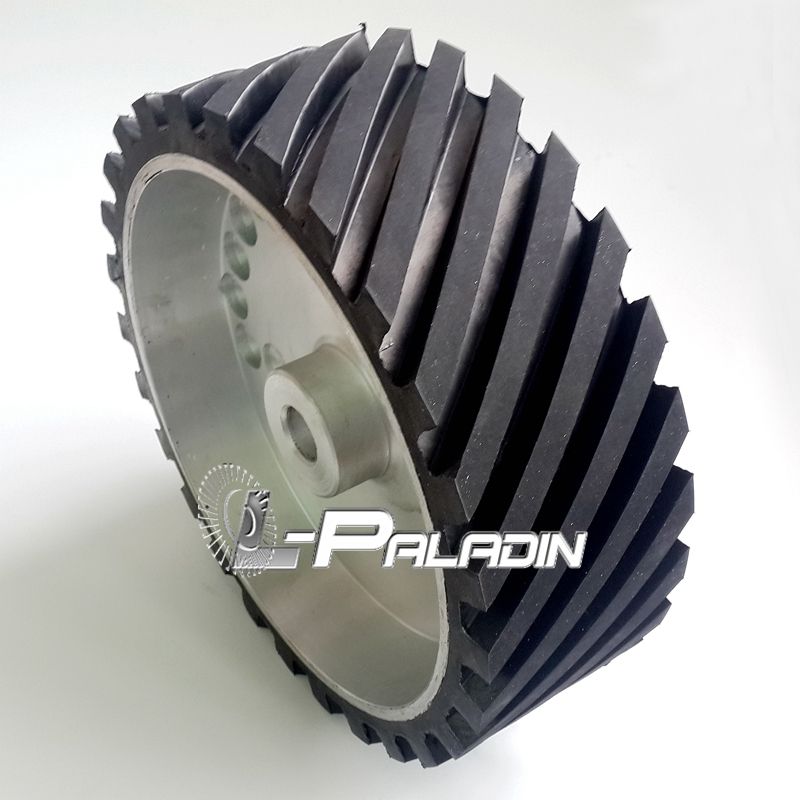

You should be researching belt GRINDERS, not sanders. They run much faster, and use a contact wheel instead of a platen. Much better for metal work.
I probably should have been more precise in my terminology - to be fair, what I'm considering is either something like this:
(Dake belt grinder 3 x 79 inch belt, 6,600 SFPM, 4 hp motor )
or something like this :
(Baileigh 20inch disc grinder, 2HP , 1100 rpm)

Looking thru some of the options available out there - and what I'm seeing is a number of manufacturers who sell the 3"x79" belt sanders - and depending on the make , they spec them as spinning at ~ 6000 - 6600 sfpm. I've seen some cheaper ones on Ebay - that are the same size but spin in the ~ 3000-3600 range.
Then there are 6" x 79" units available - but those are all slower. Some spin in the 1800 sfpm range - I think I saw one or two that are in the ~3000-3600 range.
How important is the speed? I'm assuming that the speed is mostly important for the metal removal rate. Am I correct?
DBendr
Dec 30, 2015
377
It's very critical to keep the heat down.If you're grinding something going into heat treat it doesnt matter. Something already treated you slow down or cool constantly. Wood will burn and the belts themselves will actually get smokin' hot on a fast machine. You'll see grooved contact wheels once in a while on commercial rigs ( fast). Those wheels help cool the belt.
Almost an impeller effect.That's why it's done.
Ok - That makes sense.
So faster is probably better for metal - less time grinding probably means less heat transmitted to the piece.
