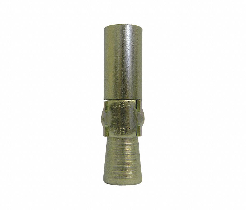

I wanted to fab a floor stand that I can fasten attachments to. I want the stand to bolt to the floor then remove it when not needed. I would make a universal mount then swap bench grinder, vise, buffer etc. maybe add a rear shield to catch debris. Any ideas on how to mount then remove from cement?
Female concrete wedge anchors set flush with the floor. Bolt the stand down as needed. The female versions won't have a threaded stub above the surface of the floor. (no trip hazard)
