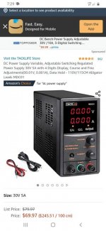

Would like to start adding some accessories to the truck now that it's warming up. Before doing any final installs the idea of having a bench power supply to test with strikes my interest. Should I go the diy route or get a small one off Amazon? Don't wanna spend over $100 for what I'm gonna use

That's the one I've been looking at on Amazon, I can't think I would need much more than that

I think something 20 amp max would be sufficient for most vehicle accessories. I may go with that one linked above from Amazon.

Cheapest is a battery and whatever battery charger you already own.
Next step up, is a used computer power supply. You need to short to pins together to get them to turn on.
You can get a 0-30V, 0-5A (or 0-10A) supply on Amazon for about $60 ($80 for the 10A).
Super deluxe, go to eBay and look for Riden power supplies or AlliExpress. These are either the front panel and electronics only or a kit (quick easy assembly). Many positive reviews online.
