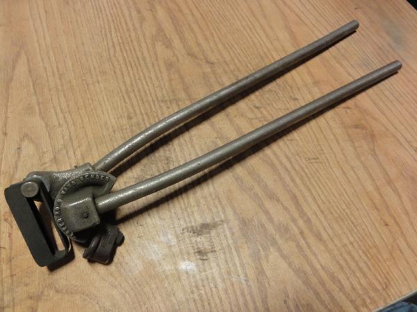

Check out Youtube for rebar bending with keywords: Brody bar, Muki bar, H.K. Porter
Lots of home made examples too.
