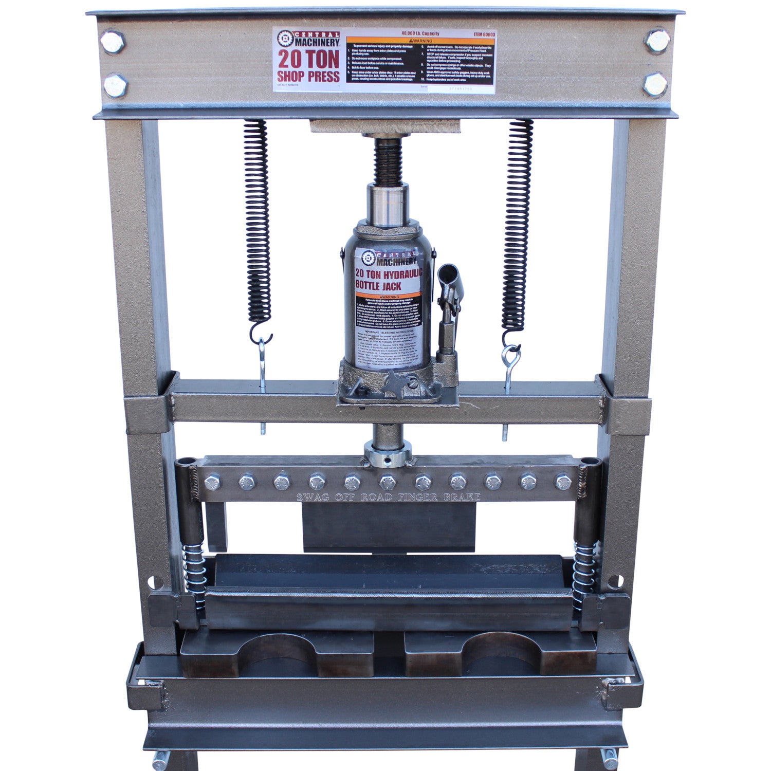

A 20 ton HF press and a swag off-road finger rake kit?
It will do it easily.
How many are you doing?
You could use a torch to heat dull red and bend in a vise if your doing a few but galvanize won’t survive that.
Hot dip may not survive a press either in that thickness as there is quite a bit of drawing of the metal on the back side.

To bend 1/2" that is 4" wide you need an extremely strong (lower) die and very accurately aligned (upper) punch if you want to do in a shop press. In my 20 ton I stop at 1/4" and 4" would squeek in under limit - but just a bit. You could easily do this in a decent size (50 or 100T) but if you were going to, you would already have the punch, die, press and experience and wouldn't be asking here. This is a 5 minute job in a press brake - and the correct tooling will already likely be in place.
Worth noting: the force to bend depends upon the bend (punch = inner) radius and the die width (usually 8x mtl thickness for an "air" bend. Just did some lookup: 11 tons required in a 4" die (size recommended for 1/2") but 16 tons for 3" (and even THAT would be a large die from Chineseum tools for little brakes).
Are you making one or many? If you are a GJ tool freak it would be a good excuse to set up a 50Ton press to do breaking, as once you are set up you WILL use it a fair bit. If a one off or even 10 or so pieces a very simple and cheap thing to do on a brake. If this is a bracket, we must assume holes need to be drilled. If you want to do this with best protection for outdoor exposure, layout, drill and cut from flat bar and take it to a break operator for the bends - THEN hot dip galvanize so the cuts, holes and bends are all evenly and fully coated.

1/2" x4" is going to take somewhere in the 85 ton range to bend with a radius less than 2".
The heavy duty swag off road will do 6" of 1/2" steel.
Those look to be about 3" dies. I would expect it will be capable of 4" of 1/2" at 45 degrees but you had better have your flat bar jigged square and dead center under the single (and not very stiff) point of force from the press. My punches for the 20T are screwed into the top moving beam to try to stay reasonable straight. Doing this kind of work in a shop press with such mickey mouse tooling might seem careless - but it has worked for me including in production jobs for many decades. The secret is in knowing when you are in over your head and move to better tooling.
Wait a minute: did I just admit that anything less than perfect might be "good enough"??? Please mods, don't ban me from GJ!
