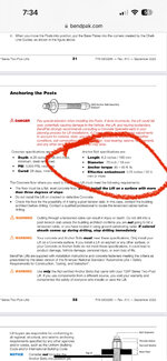

Hi everyone, I apologize in advance for bringing this up because I’m sure it’s been beaten to death somewhere else but I’d really appreciate some input on my particular case. Me and a buddy have spent a couple days installing my new bendpak 10apx lift and I’m heavily concerned on the depth of the anchors. Admittedly we worked too fast and read the instructions minimum depth and drilled to that spec instead of going deeper. So I’ve got 6” anchor bolts and we only drilled 4” into the concrete (concrete is roughly 10” thick where the posts are and 4,000psi) and once they were tightened up they all ended up around 3 1/4”-3 1/2” embedment depth which is right at bendpaks minimum requirement. The heaviest thing I have is my pickup that weighs right around 6,000lb which I don’t think will be a concern, but I bought a 10k lift to utilize it if I ever want to throw a 9,500lb diesel on there and feel safe lifting it 6 feet in the air. I do plan on calling bendpak tomorrow and see what they say, but I’m also afraid I’ll get “that guy” that looks at the specs and just says “yeah you’re good to go!” Without having any actual real world knowledge, that’s why I’m here because I’d like to know if anyone else has a similar lift with similar embedment depth and if they’ve had any issues with heavier equipment. I’ll try to upload some pics of what I’ve got going on, and thank you to anyone that tries to help me out on this one. Also, because this has already been mistaken once, the black lines in the pic of multiple anchor bolts is just markings on the concrete, not saw cuts. Nearest saw cut to any anchor is probably 3-4 feet.

@pattenp yeah I thought about that, but bendpaks directions specifically stated not to drill through the concrete so I decided to follow what they recommended and now I’m regretting it
finn
Mar 27, 2005
16,611
The UP, God's country
You didn’t drill deep enough
You should always drill entire length through slab so a failed anchor can be pounded down into the stone base
Not true. That was a tribal answer at one time, but the later thinking is that when you through drill the slab, the breakout of the drill creates a reverse cone on the bottom of the slab, locally thinning it.
Having said that, since he has 10” concrete, complete overkill and a waste of money for a home garage, the breakout cone isn’t going to matter in the least.

I don’t know if this changes anyone’s minds about anything but I figured I’d post it. Bendpak instructed to drill 4 inches deep and set the anchors and that’s exactly what we did so technically we’re in spec but at the minimum requirement.

If they are installed according to instructions and meet the minimum requirements, I would leave as it is.
That’s a very good point. I’ll be calling bendpak soon to give them my specs because it’s a 10k lift so I want to be able to put 10k pounds 6 feet in the air safely. If they’re adamant that it’s safe I’ll leave it, if they’re on the fence I’ll start looking into other options
There is no min/max stated. It says 4"deep, you drilled 4". Sounds like you are overthinking it.
Drilled 4 inches but the anchor isn’t at the very bottom so the effective embedment of my anchors is right at 3.25-3.5 inches, right at the minimum requirement.

Update: I called Bendpak and talked to 2 different technical support people and they basically both gave me the same answer, if it meets the minimum specs it’s good to go, which is a very general answer and didn’t make me too comfortable. So, I had the idea to call the structural engineer that set up the foundation plan for my building and he said he was not comfortable with their depth only being 3 1/2” so now I have contrasting opinions. Thoughts?

my opinion is that you’re overthinking this and entering the paralysis zone.
Do a free body diagram analysis of the lift. If it’s loaded properly, each arm will have 2500 lbs max load, and the load will be balanced front to rear. That 2500 lb is the permissible load on any one arm, if I remember the information in the installation manual. You aren’t lifting 10000 lb on one arm, fully extended.

Bendpak no doubt has some engineering behind their recommendation. Eveything here is anecdotal.
After all gravity is mostly what keeps these in place.
Sensibly racking the vehicles you lift will prevent too much cantilever which is what you are worried about.
If uncomfortable with the current mounting just bore a couple more holes through the bottom plate and sink another couple anchors deeper.
