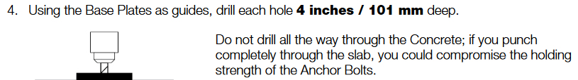

The manual for your lift clearly shows threads above the nut (number not called out specifically):1680016588221.png
It also very clearly states not to drill through the concrete, so your installer would probably have followed this advice:
Your installer's problem is that they torqued the wedge anchors BEFORE they leveled the arms. Your manual very clearly states the order in which this should be done, and now there isn't enough thread showing above the nut. If that many shims are required, they should use longer anchors to ensure enough embedment:
I think you should check your A and B distances. Did they shim the hell out of just one post, or were both posts shimmed to split the difference (which might help you out):
Snips are from here: https://www.bendpak.com/GP-7-Series-Two-Post-Lift-Manual-5900209-BendPak.pdf
