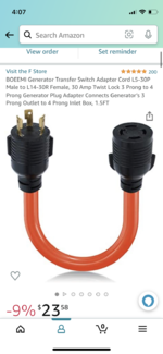

I recently purchased a used Bendpak HD-9 for my shop. The shop currently has a 220, 20amp, 3 prong locking receptacle for an air compressor that I no longer use. The lift has a 4 prong pigtail already installed. Amazon offers an adaptor that allows me to plug the current pigtail into my current receptacle. Any reason I should not go this route? It seems like the easiest/cheapest solution--but I dont want to damage anything.
Sorry if this is a silly question. I know nothing about 220 wiring. Thanks in advance.

Someone didnt know what they were doing or wanted to plug it into an existing 4-wire outlet.
The HD-9 is 240v only meaning you only need a 3-wire receptacle- 2 hots and ground. The breaker also needs to be 25a per the manual so it should be hardwired or use larger plug.

First: thanks for all the responses and thanks for taking pity on my lack of electrical knowledge.
Second: This next question is not because I am not listening or heeding everyone’s advice. I am, and plan to do this correctly as per yalls suggestions—but electricians in my area are booked out for months.
That said: am I going to screw anything up if I use this solution as a band-aid for the time being (photos below)?
I just need to get the casters off and an empty boat trailer off the floor (for storage) for the time being.

It mentions a generator transfer switch. I have similar setup for my gen backup setup for the house. On mine, it is two separate 120v circuits that are split in the house panel so the load is shared by both legs. The 4 prong plug is on the generator side, 5500 watt. No idea if this is the same on yours. Not sure if this helps.
