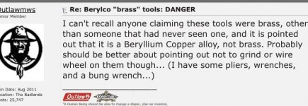

Measure 11/16, wondering what they were for, search on this forum found Outlaw saying they are a copper beryllium alloy, don’t grind on them! Why I found four in one place is a mystery. Polish a little and make a lamp? (Laughing).IMG_5573.jpg
