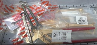

A few Facom Copper Beryllium and titanium tools.
