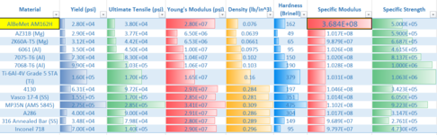

Check out this Aluminum - Beryllium alloy (AlBeMet). Nothing special until you see the specific modulus (stiffness per weight). It's unreal.
