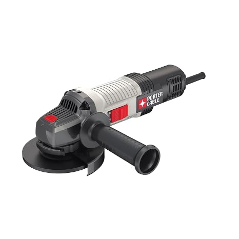

I absolutely cannot stand the cheap Porter Cable corded ones. When cold, the cord is stiff enough to be used as a tent-pole, they have no vibration isolation, and the gearboxes/motor scream. The Chicago Electric ones are just as bad.

The PC paddle switch is very inconvenient, and has broken twice.

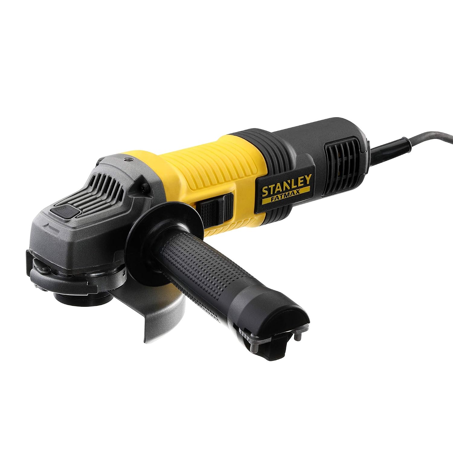

Thats sounds like a good tip actually, we have them here too in 240V, there is a video online with a guy taking this apart and its seems to be excellent value;
looks like its available across the SBD range too if orange is not your colour;
