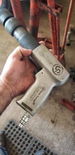

I don't think CP makes the 715 anymore, but it was the best bang for the buck for a long time. For under a $100 it more than held it's own with more expensive ones.

There's actually a seller on Ebay right now with a few CP717s for sale that are .401 shank instead of the usual .498. Messaged them and they didn't know the story behind them. Thought about getting one, but I see that chewing through bits like they're nothing.
That positively looks counterfeit to me. Looks like someone with a set of HF letter stamps started stamping on the handle.
Looks real to me. The old ones had serial numbers that were hand stamped like that on the opposite side. Even has the CP logo on the barrel. Also has an OTC number and kind of resembles OTCs old light blue so maybe they were special application or prototypes for private labeling.
Serial, sure. I have an old CP717. It’s stamped Chicago Pneumatic New York NY with an actual logo. Nothing as crappy as that knockoff.
For what its worth he'll take $140 for the weird .401 717. Like I said its CP branded on the barrel and everything about the body is correct so I very much doubt they're fake.
I have no doubt they're real and were just a private order for some company at some point. I've just seen the damage the 717 can do to the .498 bits already, let alone the .401 AJAX bits I've chewed up with a PH3050 in some jobs.
