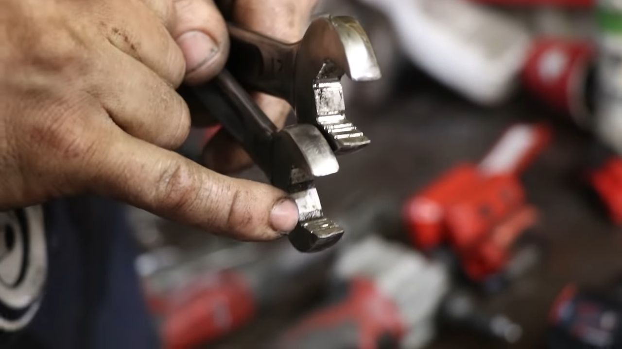

I noticed at HomeDepot that Milwaukee wrenches seem to have very aggressive teeth for "bite":
I don't have any Milwaukee hand tools, but they seem quality. Their adjustable wrenches probably have the smallest jaw slap among all brands.
Those are really interesting, thanks! Hadn't seen these before. Looks like they aren't stocked in store at HD on Canada, but you can order them. $150 CAD for a 15 pc set up to 22mm is a very good price, too.
Reviews are also very strong on HD, many people saying they are mechanics and use these.

So you're saying the Milwaukee's are an Infar product? What do you mean by "it will serve you well depending how you use it?"
How comparable do you think they are to the performance of the Wright Grip open end?

YES, my understanding that INFAR (Taiwan Tool Company) makes milwaukee's wrenches What do you mean by "it will serve you well depending how you use it?" I mean that it will not take the abuse that a snap on flank drive plus wrench will but, they are considerably cheaper too. I mean that as long as you're only using your hand and arm strength, the wrench will perform as designed. all bets are off when using pipes, wrench extenders, double wrenching, etc.
I believe there are more that a couple of You Tube videos comparing anti slip open ends. Watch those. additionally, there's more to a wrench than just its anti slip open end.[/QUOTE]

The Milwaukee wrenches were mentioned unfavourably in a youtube vid I just watched. :(
Skip to 6:55
Skip to 6:55
<iframe width="560" height="315" src="https://www.youtube.com/embed/okNZk4dbaMI?start=415" frameborder="0" allow="accelerometer; autoplay; encrypted-media; gyroscope; picture-in-picture" allowfullscreen></iframe>
Huh, well that is disappointing to see. I'm sure he uses his wrenches a lot more than I would, but still not good to see the teeth get mashed that bad. You have to think the fit on a bolt would get sloppy and kind of have the opposite effect of biting.
I wonder if Milwaukee would warranty the mashed teeth under the lifetime warranty? Still a PITA but could exchange your high use ones every couple years.
