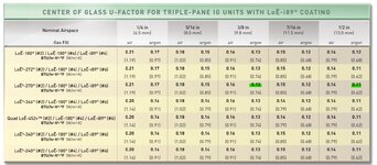

The coatings being used are Low Emissivity or LowE/Low-E for short where it manages the solar/UV rays to get the desired end result. They can be configured to have low Solar Gain(SHGC) which is better for cooling climates in the southern US where goal is generally to reduce cooling load, or it can be done for a "High Solar gain" more common in the north where extra solar heating is often desired due to a heating climate. Again this is a deep rabbit hole....more can be learned at:
Vitro(formerly PPG) who is a major/the major player in commercial glazing/coatings:
Cardinal Corporation who is the major player in residential coatings/insulated glazings:
As building codes, Energy Star requirements, consumer demand continue to get tighter, the window/door market must respond. Due to the previously mentioned 60-70% of the thermal performance(U-Factor) coming from the glazing package....changes to the glass and or coatings are critical.
For the bulk of the product sold in the US, it's a dual pane insulated glass unit with (1) Low-E coating, generally on Surface 2 but sometimes on 3 as indicated in the image below from the above linked Cardinal Tech Glass Guide:
That LowE coating is typically made up of 1, 2 or 3 layers of a silver oxide coating that is "sputtered" onto the underlaying glass. As I'm most familiar with the Cardinal products and they're the bulk of the residential market, their "standard" coatings are below:
Cardinal 180: (1) coating of silver and gives 80% visible light transmittance, this is a high solar gain coating and generally used in heating climates(northern)

The challenge is that for dual pane windows, .20 U-Factor is about as good as it gets. Yes there are some ways to get that number a bit better here or there....but that's the effective functional limit for thermal performance in a dual pane product with current, consumer ready technology. So to get better, the cheapest way to accomplish that today is with triple pane...aka another piece of glass allowing an additional airspace to act as a thermal barrier and another option to add another LowE coating onto. When you do a triple pane with (3) coatings, you can get down to a roughly .11 U-Factor, or 2x'ing the performance value from that dual pane unit:
The challenge here is that the .11 U-Factor highlighted is now a very thick insulated glass unit...because you have:
1/8" thick exterior pane
1/2" airspace
1/8" thick middle pane
1/2" airspace
1/8" thick interior pane
For the non-math majors...that's 1-3/8" thick, and we said above a common thickness was 3/4"...yikes! Then as the window gets bigger...those panes have to get thicker. 1/8" thick panes are generally good for glass up to around 18 sq ft...as you get bigger pane thickness jumps up to 4mm, 5mm or 6mm...again making that total IG thicker.
This means that in order to accommodate that, there is probably some significant design changes that would have to occur....which is both costly and expensive. Those costs aren't going to be incurred without the expected positive financial paybacks....so either big sales volume has to happen as a result or price increases for that performance....or more likely a combination of both.
Now there are some products such as the above mentioned "fixed" or "direct set" product that can more easily(and often already does) have that thicker IG units in it for exceptional performance options, but on windows like hungs or sliders with multiple sashes it's challenging to get that thick of an IG into the frame. Your standard vinyl window has a total thickness of the frame from interior to exterior of 3" or 3-1/4"....not easy to get (2) piece of IG at 1-3/8" thick plus all the associated pieces to hold them in place, go up and down etc in that package. Make the frame deeper is an option...that then adds cost and window packages are one of the 1st things to get "Value engineered" in todays building environment...so yeah...what to do. Go back to the coating options and figure out just how much performance we can get out of the existing IG package...which normally means give consumers the options of additional coatings if they want better thermal values. When they want even better than dual pane....jump to triple pane....when want better then that....there are some quad pane and other super exotic stuff out there when budget and payback period aren't really in the priority bucket
It's also important to note that the values in the above charts are "glass only" U-Factors and not complete window/door values. The values you see on the window/door you order or what a manufacturer advertises is the complete "full unit" value and takes into account both the glass as well as the surrounding elements(sash, frame etc). That full unit U-Factor in todays world will be worse than the glass only value, so that .20 U-Factor for glass only could translate to a complete unit U-Factor of .23 to .27 U-Factor depending on what it's going in. That "full unit" U-Factor is what building codes, energy rebates, Energy Star etc is based on
So in summary:
