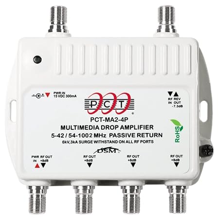

When they installed cable TV in my house they did "home runs" using RG6 to this
The wire and this amplifier/splitter are all there. I actually pulled Cat 5 to 2 bedrooms before 802.11 was widely available (at a reasonable cost). Now I have one wire going to a combination modem/wireless access point. Everything else (4 streaming TVs, 2 notebooks, 3 tablets) is wireless.
One of these days, I am going to hang an OTA antenna and start using that amplifier/splitter again (he said 2 years ago) !
