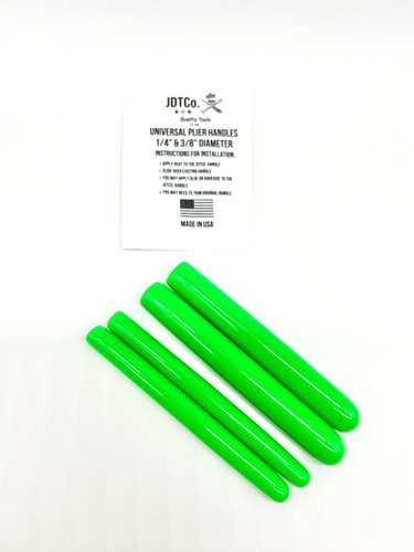

Is there anything better for replacing tool handle grips, specifically long nose pliers, than Plasti-Dip with their primer? I have an old Stanley pair with funged grips that I had to remove.

Yeah plastidip for hand tool handles ****. I've seen these by Klein online. They come in 6" & 8-9". I've never tried them though, haven't had a need yet, but they don't appeal to me.
I also remember finding another manufacturer that offered a lot more sizes & colors. I can't rememeber the name though & at the time I couldn't find anyone who sold them.

Someone was making slip on grips that you heat and they shrink to fit
This is what I use. I get it off Amazon. Heat shrink. Usually use 1/2” and 3/4”. 2 layers work great.

That looks rather good - especially on the ratchets. I wonder if there is maybe a slightly thicker softer material that could be the first layer?
