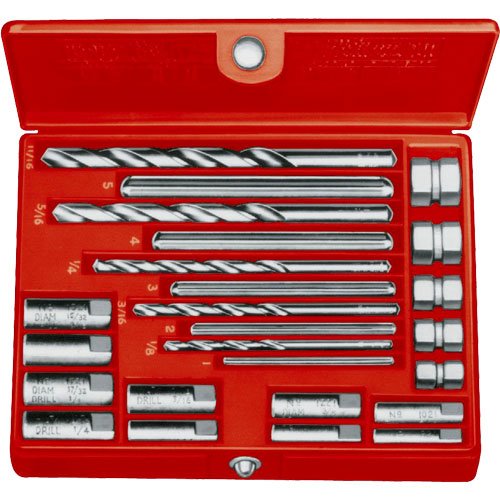

:mad:broken bolts in a truck radiator.. snapon and mack ezouts broke off and now i cant even drill again cause the exout is just as hard as the drill bits.. alum rad and steel bolts . heated every thing up and all that chit.. never have luck with ezouts.

Is it possible to weld a fairly large nut to the top of the broken off bolt without damaging the radiator? Try tacking the nut on with some good, penetrating tack welds. Then slowly build up the weld within the nut. The heat should help loosen things and the nut will give you something fresh to crank on with a wrench or socket.

I wont use them till I drill damn near all the way thru the stuck bolt. Had too many snap on me

THIS is why I tell everyone to not use EZ-outs.
A left hand drill bit is the best bolt extractor ever.
Your options now? Wire EDM LOL

bluepoint sells a set that I believe is repackaged made by ridgid ,they include the left handed drill bits , a set of spline extractors and matching nuts that slide over the spline so you can use a wrench on them . I live in the north east and we have lots of rust and broken hardware and I have used every type of extractor that I know of and tese are far and above better than anything else drill the bolt centered heat it up drive in the spline piece and workmit back and forth and it will come out. all te spiral type ezouts are good for is removing bolts that will turn easy , because the harder it turns the more the spirall bits in and the more it expands the bolt and wedges it in tighter totaly defeating its purpous
Here's the Ridgid set, also sold as bluepoint. One reason I like them is because you can buy replacement parts from Ridgid.

Plasma/Oxy-Acetyl is one choice. Cobalt Drill bits (or even better, Molybdenum drill bits like the viking/norseman/drill hog drill bits) work okay, but that'll be slow. Carbide tooling would be great, but unless you can get the entire thing in a mill (is it stuck in the car or radiator?), that's hard to do.
Extractors are really not to be used with seized bolts. If you snapped the head off a bolt trying to loosen it, an extractor is highly unlikely to be able to remove the bolt. You already snapped a piece of steel that is the diameter of the bolt, and now you are trying to use a smaller diameter tool to remove that same stuck bolt. It just doesn't work.
Extractors are more useful when you round the bolt off because you were working at a poor angle or you overtightened the bolt and snapped the head off. The threaded portion in that case should have no tension on it, and will be drilled and removed easily with an extractor.
Best bet is to drill the bolt out completely with a left handed drill bit in general. If you're careful, you'll be able to pull the remnants of the bolt out with a pick. If you're not, you might have to retap it (not too bad). The next option is to heated/quenched the fastener to break the rust bonds between the fastener and whatever it is in, and use the LARGEST diameter extractor tool you can.
I used to use extractors a lot. Now I just drill bolts out completely and have had way less problems.
