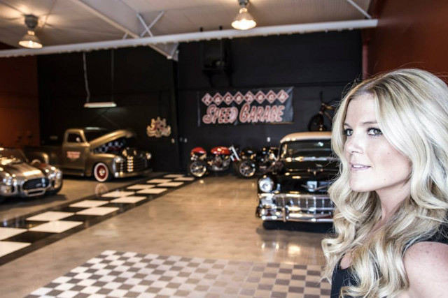

Drop a hammer on your 1x2 from 4’ and let us know what happens. For a car parking garage, big tiles should be ok. For a working shop, I would not recommend it and doubt you will find any working shops with big tiles.
pbon
May 14, 2017
3,498
Exactly. The show garages in the article use larger tiles, probably because they look nice, and they are probably fine for show garages. The working shop uses small ceramic tiles because they are more durable and less likely to break.

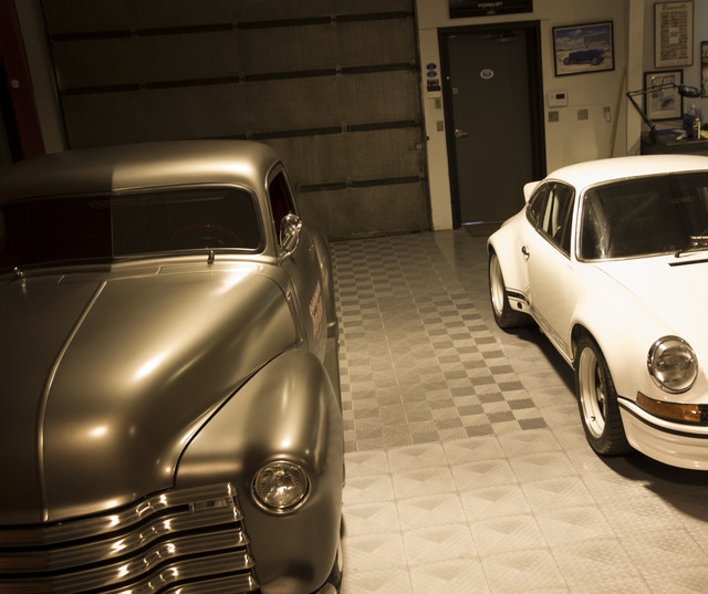

This RaceDeck TuffShield Diamond garage floor is going on approaching 10 years since installed and a lot of vehicles and mechanical upkeep throughout the years - The subfloor was terrible with saturated oil stains, pitted & cracked and dips in concrete that were leveled. The RD floor itself was a 1 full day installation.
