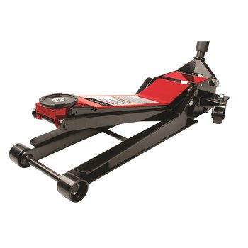

The AC Hydraulics jack was one of the first low profile jacks I came across, but the capacity is really low @ 1.3 tons. The 2T jack isn't as low profile.
I think my next jack will be the Sunex 6602LP, 2 ton capacity, lower pad height than the AC 1.3T jack, and it's also shorter throughout the length of the arm, which means you can jam it further under a low car. Doesn't lift as high though (24" instead of ~29", but I rarely need to go that high anyways).

Just for anyone interested, the Sunnex 6602LP shown in post #8, is the same jack as the Arcan XL2T and the Harbor Freight models 60678/68050. The Harbor Freight is the cheapest plus it has a foot pedal whereas the other two don't.

Link to where you've confirmed they are made by the same company to the same specs and are just rebadges?

Well you don't need to be a rocket scientist to see that the sunex and arcan share the same advertising picture with only minor color photoshopping to highlight the color changes. If that doesn't do it for you, I will post the manuals below. There is only a handful of hydraulic companies out there and they will market there design to every retailer who wants to sell a jack in there color scheme/stickers, with that said sometimes you get subtle changes including seals/cosmetics in the jack. Which is why I'm a wee bit Leary to judge some of these jacks simply by color and claim X is identical to Y, especially when the manuals don't detail the hydraulic seal components, its impossible to keep up with all these retailers, they change designs so often. In the case of these jacks... I'm fairly confident at these price points they more than likely identical jacks. I generally try and stay out of these threads, My advice do your research, read the manuals and buy from the retailer who offers you the best warranty.
Sunex
Arcan
HF with subtle differences.
