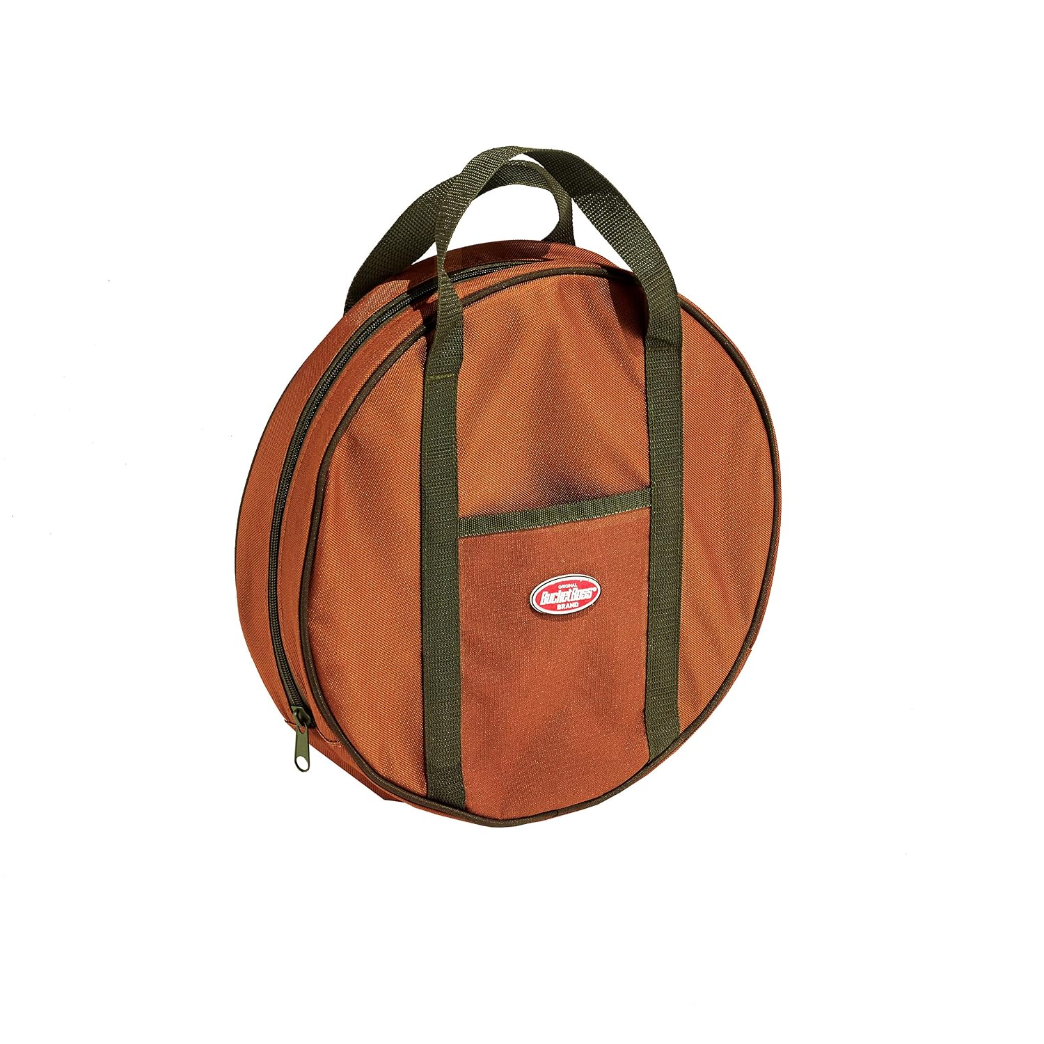

I have the Deka cables too. Another bonus is that their all-copper conductor, not aluminum cladded in copper like the el cheapo ones.
Only drawback for the Dekas is the carrying bag. It is not durable.
Mine came in a blow molded case back in the day. THAT disintegrated years ago and I used a variety of bags and totes until buying this from Amazon for about $18 three years ago:
