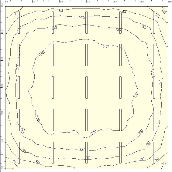

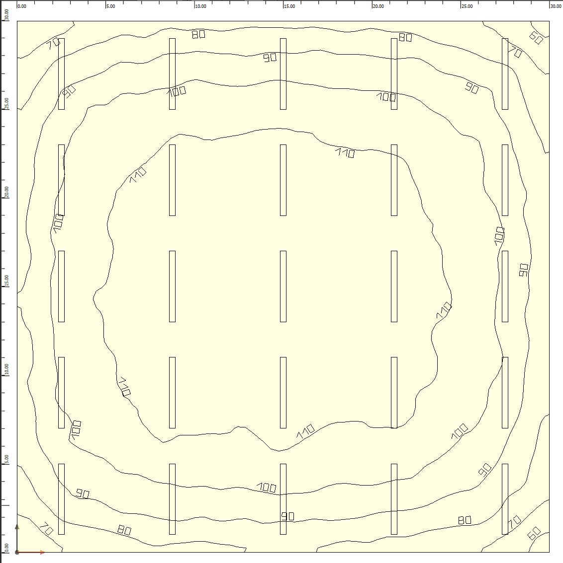

25 fixtures (50 bulbs) 5 rows of 5 fixtures from the best light fixture thread will give you 100fc @ 30" workplane.

I'll post a layout later. You could get away with fewer fixtures and just use task lighting over the work bench, but I think at your (our) age you'd be more comfortable with the full 5x5 layout if budget permits.
