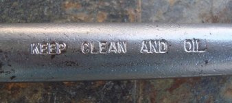

you mean like this?
I'll stick with the manufacturer's recommendations. ;)
