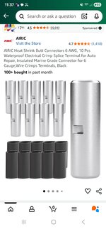

They make #6 **** splices too but pretty sure should only be used if wire is stranded. For example:

Polaris connectors are the gold standard, and they're priced that way. If you're ok with a single-use product, what I've done instead of a Polaris connector on the cheap is use these:
and sleeve that in (adhesive lined thick wall 105C 600V rated) heat shrink tube.
The combination sold as a direct burial splice kit with two pieces of tubing for a lot more money (more than a Polaris):
But in a weather tight box, you don't need to direct burial levels of protection.

In a 4x4 box, I believe split bolts would offer more flexibility and take up less room than Polaris.
**** splice type would be nightmare in a 4x4 box.
So, I had this exact issue., and the **** splices I mentioned fit much better than the split bolts I used before them (the replacement was to add a ground wire feed to an out building), but both worked (barely). Split bolts are the biggest of the options, once you account for the golfball of tape around them. The four **** splices end up pretty thin, so I was able to loop the rings of wire in the box easily. The three split bolts they replaced were TIGHT, and there's no way I could have gotten a fourth in there.
Polaris style generally take up the least room, since the insulation is pre-cast tight to the metal, though you do have the hubs that stick out in places.

I use the style of **** splice you pictured for service temp connections. The smaller versions could still be too big for the 4x4 box the OP has but depends upon conduit/cable entry locations and available conductor length. Would surely work with pre-planning knowing the wires are going to be positioned for their use.

I can not IMAGINE #6 SOLID wire !
The problem with those **** splices is having crimpers big enough to use them.
I wasn't sure if the wire was solid but know enough that those crimp connectors should only be used on stranded. Believe I have seen 6GA solid wire for ground connections though.
I have a Temco hydraulic crimper that can handle 6 GA (and larger) just fine. They are widely available in different brands and styles. Mine looks like this:
