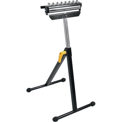

This is my favorite stand for someone that is actually cutting trim, molding, or 1x4 stock a lot. If you're using it for more than that, I really really like this:
with a pair of these

I think any stand that is not moving around, i use that collapsible dewalt and one roller. I much rather use saw horses with a secured (1") 2x8 piece of plywood and a couple of blocks on each side at the same height of the saw table and one or two rollers to use with the hella long pieces. And... a makita 10" sliding compound miter saw.

I also have the Dewalt DWX723, along with some roller stands for 16' boards. That's a great setup and both fold up for minimal storage space. The ones with wheels are nice, but are bulky.
