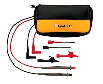

The gator clips on this pic below are part of my tool load out. These snap onto the end of the leads. I think I have what they call the "deluxe kit" with the hoop clips for snatching component leads and what not but the two most used are the basic clips in the below pick. I also rely heavily on the needle leads shown in that pic. Imagine taking the cover off the end of the needle lead and finding a syringe sharp point. That's how I can get into some pretty tight spaces. It's also handy for testing right through dielectric in some cases. Especially if someone has done a scab job and I need to get through 1/8th inch of electric tape on a hot circuit.
The black clip stays on the meter and gets clamped to ground so I can poke the bits that need pokin' and either hold a drawing or a flashlight.
On that topic, the Magnet for the meters is super helpful too. The magnet will eventually rip through the rubber boot due to it's strength, then it's time for another. I've worn out 2 or 3 of them at least but it's super handy to walk up to a cabinet, slap your meter right there and get to work.
