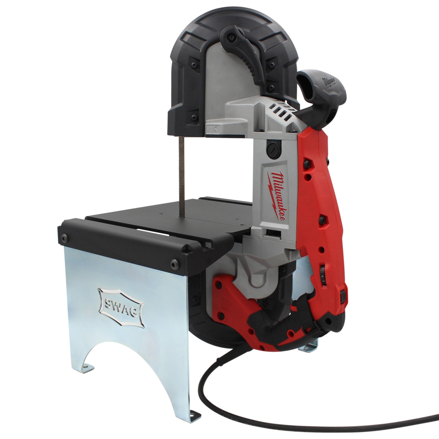

Despite having an embarrassment of riches regarding the variety saws in my shop, they're not very portable. I LOVE the Milwaukee portaband, and over the years I've collected a few of them.
I'd like to dedicate one to a stand to turn it into a pseudo-permanent mini vertical bandsaw for when I'm on the road.
Who makes the best one I can get my hands on?

Lots of people like the Swag brand. I don't have one, but I've been considering one for a while.
GeoBruin
May 5, 2018
3,742
I'm assuming for vertical use? The SWAG is pretty ubiquitous and probably hard to beat if you don't want to make something yourself.

I’ve had the SWAG for my Portaband for about ten years now. Took a little fiddling to get the saw to fit
I had a bigger bandsaw too but got rid of it when I didn’t use it after I got the SWAG/Portaband
It is one of the most often used tools in my shop. The miter slots are useless unless the blade is very new. Mine is starting to rust a little so if you can order it painted it’d be nice
A good low profile work light helpful and the cheap on-off foot switch from HF make it a pleasure to use.

I'd suggest a SWAG table then. Check out the options available and just order them. I'm sure there's a way for you to write it off or part of it as shop use. I believe I did buy the miter gage off Amazon, I believe it was many dollars cheaper than what SWAG was charging.
I bought mine unpainted and did that myself as I didn't want the table itself powder coated. I figured it would just scratch up and look like ****.
They offer several different table models for different saws. I suggest getting a saw for the bandsaw and leaving it mounted up.
If you were closer, I'd tell you to come check mine out.

I have a Swag for my corded Milwaukee and it’s fantastic. It’s definitely one of those tools I don’t know how I went without for so long.
I haven’t bought one yet, but these new Readysaw mounts look very nice. They’re more expensive and designed to be more quickly convertible / configurable than the Swag setup.

Question to all the Swag guys: Does that unit let you use the bandsaw both vertically and horizontally? That’s the reason I bought the Hercules one at HF - when I cut long and heavy 2.5” tube I can keep the tube on the floor without needing to lift it more than a couple of inches.
It basically mimics a cut off saw, but without all the dust of the abrasive kind or the expense of the cold version.

My Swag is vertical only. I have a Milwaukee mounted on it and an old Porter-Cable that I use for free-hand horizontal cuts. Porter-Cable did make a bolt-on stand for horizontal cutting.
