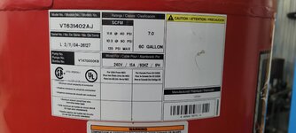

I picked up a HuskyPro 60 gallon compressor that has no cord on it. I have a 12/2 run into the tool room on a 15A double pole breaker. I started mocking it up with BX but I don't see anyone else using BX but SOW or SOOW. I do have SOOW on hand but is there any reason not to use BX? Is vibration an issue?

I would use the cord as it can take the vibration much longer. Bx/ac is best for permanent, fixed, vibration free installs. Not on equipment.

The #12 should be okay. 15 amp breaker isn't going to cut it. You could try a 20 but I would recommend a 30A

Mine is rated the same. It runs and holds fine on #12 and a 20A breaker. Uses a 6-20R plug actually. Stranded cord would be best.
6-20 is only rated to 2 hp, the OP motor is 4 hp if we go by the kw number. If you use the amps it’s still over 2hp
Most NEMA plugs are limited to 3 hp on motors.

6-20 is only rated to 2 hp, the OP motor is 4 hp if we go by the kw number. If you use the amps it’s still over 2hp.
My 3 HP table saw came equipped with a 240 V NEMA 6-15P plug on it; the instructions say to use a 20 A power mains with a suitable receptacle (NEMA 6-15R or 6-20R).
My (so called) 4 HP air compressor came equipped the same way with a 240 V NEMA 6-15P. It only delivers 7.7 SCFM @90 PSI so I'm guessing it's about 2.5 HP actual.
Both of these are on separate circuits with 20 A breakers and 12/2G romex feed from my panel about 25 feet away.
It's hard to make hard and fast rules with power mains ratings when the air compressor manufacturers play games like this. I thought they would have learned their lesson a while back with the lawsuit settlement, but apparently not.
His motor is rated SPL just like mine. Factory 6-20R cord plug.
There is deliberately no HP rating on the motor, otherwise the HP limit of the plug would apply.
SPL means nothing to the NEC. Its just an attempt to fool people into buying substandard ****. And it works apparently.
If it does not have horsepower listed on the nameplate, you would have to follow
430-6(A)(1)
"where the motor is marked in amperes, but not horsepower, the horsepower rating shall be assumed to be the corresponding to the value given in Table 430-248"
According to the table the motor is over 2 hp.
Now if the cord and plug comes on the compressor from the factory wyliesdiesels in post 18 would be correct. Although I still wonder about the receptacle side motor hp being exceeded?
But you are suggesting that the OP use a plug that is not factory installed and isn't rated for the HP per NEC 430-6(A)(1) and the manufacture of an installed on cord 6-20P just because yours is.
That would be non code compliant advise.
