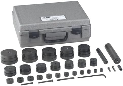

This OTC set is about the best you can get. You make your own ID/OD discs for the specific size you are working with. By having a snug ID disc, you make it easier to drive the seal/bearing/bushing in straight. Can be found on amazon and at napa
https://www.otctools.com/products/custom-made-driver-tools-basic-set

I have the OTC 4507 Bearing, Race, and Seal Driver Set, but the OTC 27794 model mentioned above looks even better, albeit much more expensive. I also save old races. I take them to the disk sander with a 40 grit disk on it and sand the outside of the race just enough so it is no longer a press fit. That way it works well to drive the new one in, yet still comes back out easily.
