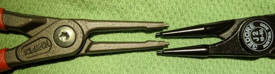

i've never owned snap ring pliers before, but as soon as the weather warms up a bit more, i'll need some for work i'm doing on my motorcycle.
after much reading, it seemed to me that knipex precision circlip pliers are among (if not) the best. however, i couldn't find the set i wanted at a reasonable price, and amazon.de is kind of a no-go right now for me in the US.
since the gedore also look very good, i got that set instead. but very soon after, the knipex became available again. so now i have both sets :rolleyes:, and i'm trying to decide which, if any, i'm returning. obviously i'm not returning used tools, so i can't really try them out to help decide. also, it's a little too cold for my liking to work on my bike.
here are my thoughts on them:
Knipex Precision (00 20 04 SB)
Pros:
  • grip material has a nicer feel
  • the markings on the grip material seem durable
  • those spring steel tip inserts are ****
  • adjustable joint (i guess you can tighten them up if they ever get too loose)
  • internal (hidden) return spring
Cons:
  • more expensive
  • the joints don't feel quite as good, surprisingly. there's a bit of wobble to them, like you can move one piece relative to the other in-plane (translation, not pure rotation about the joint). that is to say if you hold one grip in each hand and try to move them without rotating or twisting, they give a little. if i had to guess why.. the joint looks like a simple screw design. the joint screw threads into the bottom half of the pliers, but the top half (on top when the screw head is visible) has a simple hole through it. that hole is maybe slightly too big, so that's why there is some play.
  • weak feeling return spring tension
Gedore (S 8008)
Pros:
Cons:
  • the markings on the joint are already wearing off a bit where the tools rubbed against each other in the box
  • external (visible) return spring
this pic illustrates what i was saying about how the gedores seem nimbler, and you can see the tips better at an angle:
i know, it's terrible. i have both sets right in front of me, and i still can't decide. i think i can't go wrong with either, but which set would you keep?
also, if anyone wants me to take more pics or examine something while i still have both sets, i'm happy to do so.

I have every Knipex Precision. I have zero complaints and only praises.
I've never noticed the play in the hinge you mentioned, but what I have run into is on an internal clip if it is real close to the edge, the pliers hit the wall before the tips can get into the clips holes. But this would happen with the Gedores and any other ones.
indeed, both are super nice.
but see how the tips on the gedores are more narrow, and how the pin comes right to the outer edge? i wonder if that makes a difference sometimes in what you're able to grab in tight spaces:
(here is a link to this pic on imgur)
as for the joint play, here's some video clips of what i'm talking about:
knipex:
https://gfycat.com/dimwittedscrawnyafricanaugurbuzzard
gedore:
https://gfycat.com/oddballrectangularcranefly
Those Gedores are ****, except for the external spring...that's a huge turn off in my book (if we're splitting hairs here ya know.)
agreed, hidden spring looks better

First off, Thank you for doing nice camera work. The Gif was super clear.
I think everything at this point is negligible. The tip placement on the Gedore's probably is easier to see? I go by feel most of the time because there is always some obstruction and I can't get my head and hands and pliers all in at the same time.
With the Gedore tips being on the outside the beefcake-ness of the jaws must be less than the Knipex so they can still close all the way. You can see the Knipex has the "built-in-stop" on the jaws, which I never paid much attn to until your above photo. But I have squeezed the ever-lovin-sh1t out of the Knipex...just the other day removing a big internal circlip on Fox 2.5" resevoirs...and thinking back maybe that positive stop is a real good thing.
Also, my #s are still good on my Knipexs, but I don't think I've ever looked at them. I always open the drawer and grab 2 consecutive sizes...usually one of them is the correct one. lol
I think at this point, go by what feels good in your hand.

The Gedore tips look the same as the ones Knipex uses on their other series of snap ring pliers....like they're made & forged from the same base material as the pliers jaw.
By virtue of Knipex involving 2 different materials they can get one specifically suited to the tips but have to increase the beef in the pliers jaw to handle the interface.
I haven't used both but the canted tips seem like a big desirable feature to me vs. what I perceive is the straight tips on the Knipex wire tips.
the knipex precision tips aren't straight, but generally the gedore ones are noticeably more angled. i assume more angled is a good thing to reduce slippage. some of the gedore tips also look a little longer.
this shows J1 (12-25mm, internal) pliers from both sets:
pic 1
pic 2
out of all the pliers in the set, i would say that this is the most extreme case. i wonder if this pair of J1 knipex is a little out of spec.
taking this a step further, the wiha magic tip pliers (which are possibly being discontinued?) have notched tips. during the recent sale, i picked those up in 90° size 3 (internal and external) to round out the set. i don't have them yet.

Thing about the more steeply angled tips and the way they cut them at a slant is that you won't get as full of an engagement on rings in a bore since the tips will bottom out at an angle. It's splitting hairs but the Knipex just look like a cleaner more precisely made tool. On the flip side I'd prefer a riveted joint over a screw. The spring on the Gedore doesn't bother me at all. A lot of precision electronic pliers use the same spring like Klein and older (pre-spain junk) Snap-on.
I will say that etching on tool steel lasts a lot longer than the inking knipex does on the handles but you'll need to use them a lot for that to become apparent.

Here's my comparison:
Knipex Precision: pressed in tips might be more durable than regular turned tips (Knipex says they are)
Gedore: tips are angled more, so therefore might hold onto the snap ring better (this is the reason why I never buy the replaceable tip kind of pliers)

good comments. thanks, everyone. like most of you say, this is really splitting hairs. both sets are amazing.
yes, etching or stamping the model info would be better than what either tool company has done, but between the two i've got in front of me, the markings on the knipex are more durable than gedore's.
and if i keep the knipex, i'll probably just put a little strip of tape (maybe gaffer tape) on each internal snap ring pliers' handle to quickly differentiate them visually from the external ones.
My don't have play in hinges, but It's a screw so you can probably tighten them.
the play really isn't a big deal and would not affect use. probably not all of them even have this problem. i think that on my batch, the tolerance was just too high between the hole and screw diameters.
i did test it just for kicks. i tightened one a little, and the joint friction increased as expected, but the play was still there. the play can't be adjusted out.
