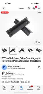

eBay Soft Jaws
The others are also cheap eBay ones. Aluminum with a strip of rubber and magnets.
