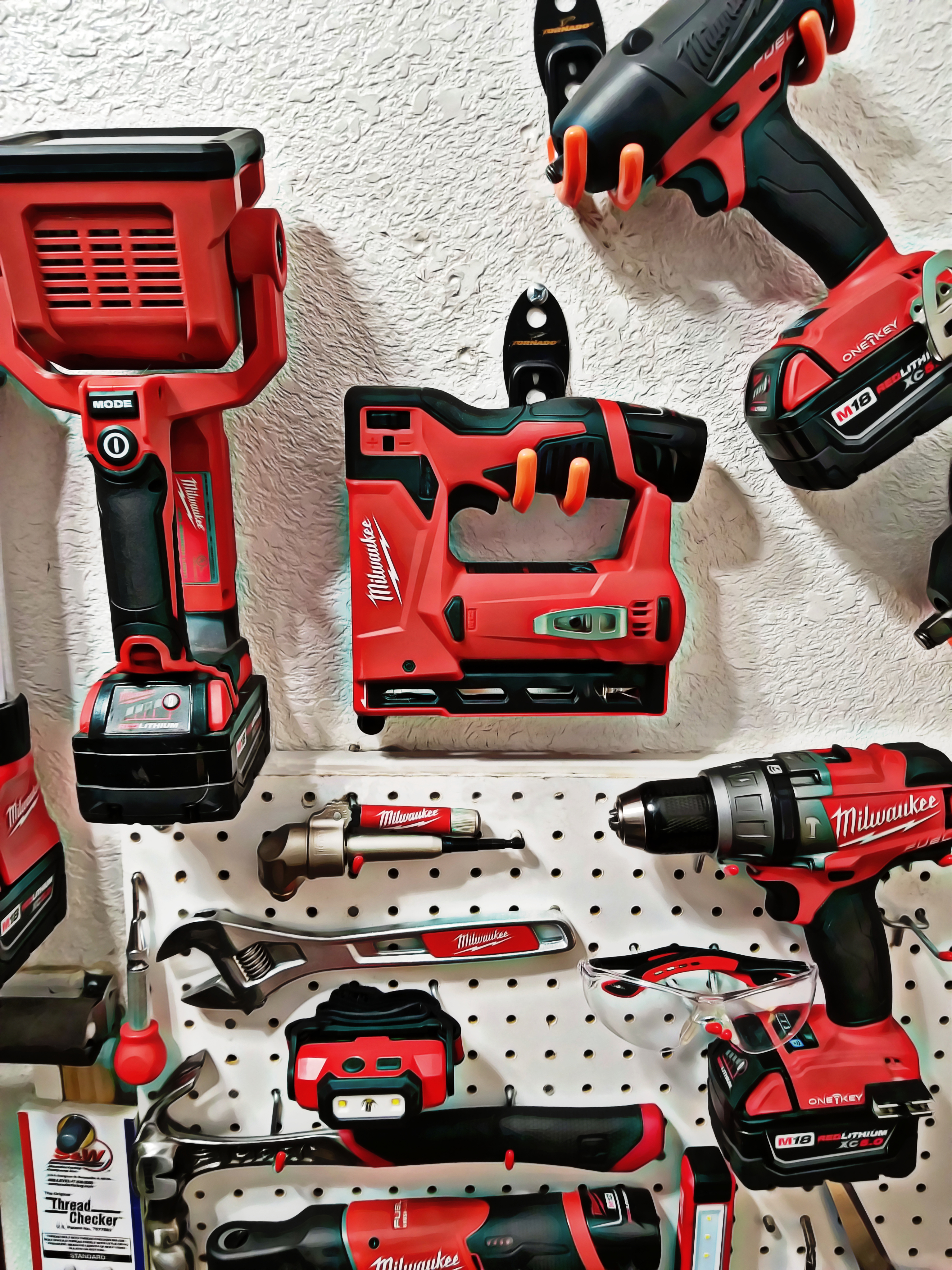

I've had an Arrow T50 stapler for years and it still works great. However after buying an electric stapler to do some insulation in the garage ceiling, I wondered why I didn't buy an electric one before. Hands down, great investment.
NUTTSGT,
Which electric one did you buy?
Best regards,
Scott
HolyGrail
Oct 1, 2012
91
M12 Staple Gun. IMO the Best. One of my favorite tools now.

NUTTSGT
Sep 14, 2009
51,046
Northern Central Ohio
