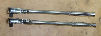

In the pic top to bottom....
1.) Kobalt 3/8" drive flex head ratchet discussed above
2.) Craftsman 3/8" breaker bar. Longer than the craftsman ratchet, but shorter than the Kobalt
3.) Craftsman standard 3/8" RP ratchet. ~10 years old and has heavy use but still going strong.
4.) Wright 3/8" breaker bar. Sorry I don't recall the model # off the top of my head. I received this as a package purchase from a member on here.
I freaking love it. If you are looking for a 3/8" breaker bar I highly recommend it. It has some really solid detents. Actually I use it majority of the time as a spinner handle. Recently I have been reaching for it over my Craftsman ratchet. The detent is strong enough to keep it straight, and the handle is a good size and knurled for use like a screwdriver handle. 90° to break the fastener loose and a quick snap to 180° to remove the fastener quickly like a screw driver. Again, I love this thing. Thanks again WP
