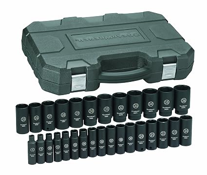

I really like my Gearwrench set, good quality, includes every size 8-36mm, and has clear etching on both sides of the sockets so you can easily find the size. Also includes a nice hard case. The size etching was the deciding factor the steered me towards Gearwrench and away from Sunex since they both seem to have similar quality and price.
