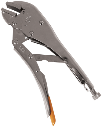

Looking for some vise grips that not only are quality but also can be released fairly easily when tightened. Any recommendations would be appreciated thankyou!
Does anyone know who makes Lang's locking pliers? They say they are made in Germany, don't quite look like the knipex's to my eye.
tarbellb
Apr 17, 2011
5,779
Oregon
$58 for a pair..... yikes. They dont look particularly special to me. For that kinda cash i would be all over

kylexj88
Mar 9, 2025
15
I agree, especially with the Eagle sentiment, however I haven't heard those mentioned yet & figured I'd add it to the pile. plus ya know curiosity and cats and all that.
