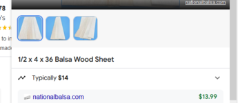

Know where I can find balsa wood roughly 3'*3.5'?
