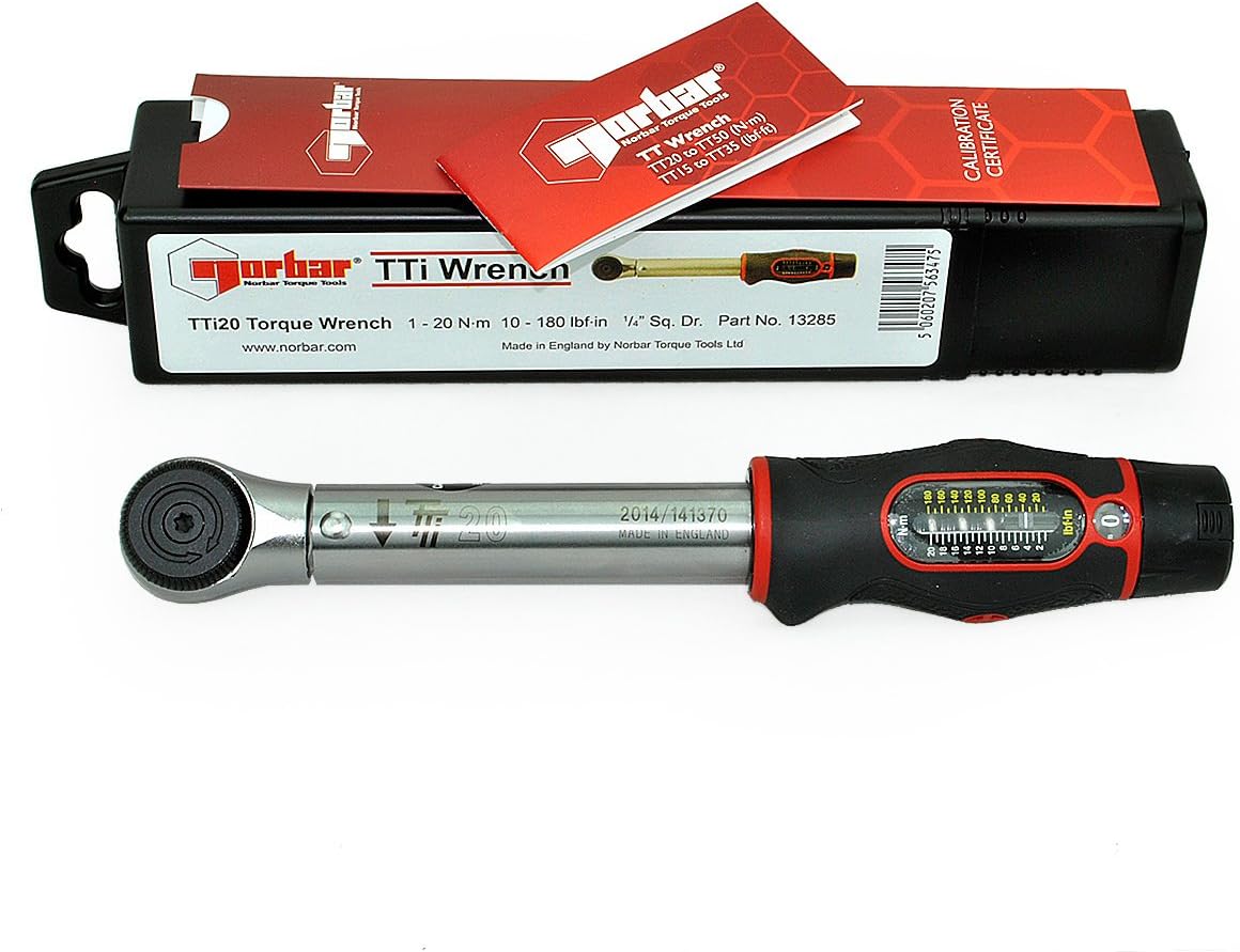

I used to default to Park Tool. MOST of their stuff is just fine. A decent portion of their line (mainly most recent additions) falls short of awesome imho.
Once I finally got a groupset and frame that truly warranted a torque wrench, I eventually settled on the
NORBAR #13285
1/4" Square Drive, 1-20Nm, Click style
Paid ~$110 in 2016
It covered all my needs and the QC certificate it came with showed impressive accuracy and precision (+- 0.1Nm)
Since I bought it (~2016), NORBAR was acquired by Snap-On but as far as I know they're still putting out great torque wrenches (Made in England).

That is the exact same one that I have. Norbar is the biggest torque wrench manufacturer in the world as far as I know. OEM rebrands for many other companies.

You cant go wrong with Norbar, solid tools built to last and reasonable pricing, my ancient 330 has passed its annual calibration check without fail for 10 years plus
Note the little window for setting the Torque, much easier to see than your typical engraved micrometer type scale
