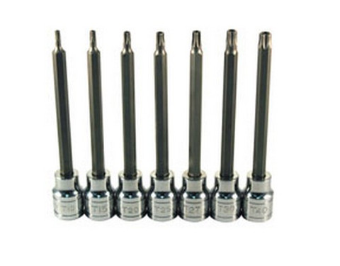

I thought I would chime in with a Torx request of my own here. I'm looking for tamper resistant Torx but sockets but long. I found these inexpensive ones, any other alternatives?
If I ignore the multitude of unnamed similar bits on Amazon, I was unable to find any named bit sets that had them, ****. If push comes to shove, DeWalt makes a relatively thin locking bit extender.. I say that in the singular but they have all different links on these. They work really well, they are impact rated. They're available in multiple lengths .
Here is a link to one of them on Amazon. Something like that might be usable with a shorter locking bit. If you need something else, want something else.
In my mind I thought that grip edge had long ones. They don't when I thought that Tekton offered long ones and they don't.
Without a stated budget, drive size, range, desired length, its hard to gauge a recommendation, but something like this Tone set might be a little better quality:
Or perhaps KTC:
Or Koken:
I own several Genius bit socket sets and they have been acceptable quality:

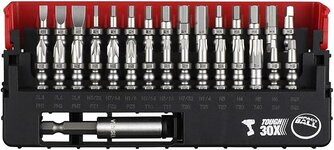

Wiha sells a pack with one each of a lot of torx sizes. Wiha bits are made in Vietnam, in a Wiha factory, but they're excellent in quality and was one of the top performers on the Project Farm test.
Edit- here's the Wiha set
Bought all these bits before Wiha started outsourcing to Vietnam. Each bit is stamped Germany. I also have a 25-pack of Phillips #2 Made in Germany and some power bits that are made in Germany, and the master set of precision 4mm bits made in Germany.
