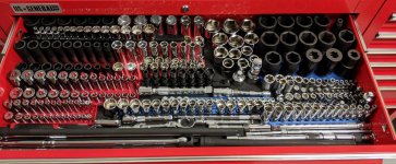

I looked into this for years without ever finding a solution that really worked for me, so I made my own. It was tedious and time consuming, but it fits my needs perfectly.
I started with a sheet of 1/2 MDF and cut it to fit my drawer. Then I layed out the sockets how I wanted them. Once I had the layout I then marked up the holes. This is what took the longest because one hole out of alignment can mess an entire section up. Once the holes were drilled I cut a piece of 1/8 ABS plastic the same size as the MDF and clamped them together. Then I just drilled through the holes in the MDF and through the ABS.
Next I needed something for the sockets to sit on. I found plastic dowels at Grainger. They come in a variety of diameters, so I ordered 1/4, 3/8 and 1/2. They came in 3ft lengths, so I cut them down to the size I needed and rounded all of the edges so the sockets slide on and off easily. Then I just tapped them into each hole. If you drill the holes properly you won't need anything to hold them in place as they will fit nice and snug.
Then I just put the completed sheet in my toolbox and put the sockets on it. It's not that bad to add to either. I bought a few spark plug sockets and added them with it still in the drawer. It's holds them really well too. I had to move the box on a truck and after a 45 minute drive and only two sockets were out of place. It was time consuming. I think I have 2-3 weekends worth of time into this, but for me it was worth it. And the best part is that it was pretty inexpensive as far as materials.....

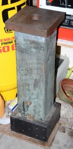

How did you bend those? I've been wanting to make something similar but don't have anything to make good clean 90 degree bends like that. Also, where did you get your stock material?
I do it like lilredex demonstrated, (I even use the same vise as his). By clamping the tin between 2 straight edges of tough steel I'd put another chunk of steel (say a short piece of 3/4" x 2" x 6" steel) placed tight against the tin where it comes out of the vise or the sandwiched metal and hammer on the piece of steel. This way the hammer blow gets spread against the whole length at once and keeps the bends in your tin nice and straight.
I also have this 11"x 11" x2" piece of steel which is my anvil. It has perfectly square edges and is real handy for bending metal on.
I'm a pack rat so I save all metal, old vcr shrouds, washer, dryer too, anything metal gets sorted and stored and used for all kinds of stuff. If I'm desperate I'll even go buy some from the scrap yards or metal supermarket type places.
