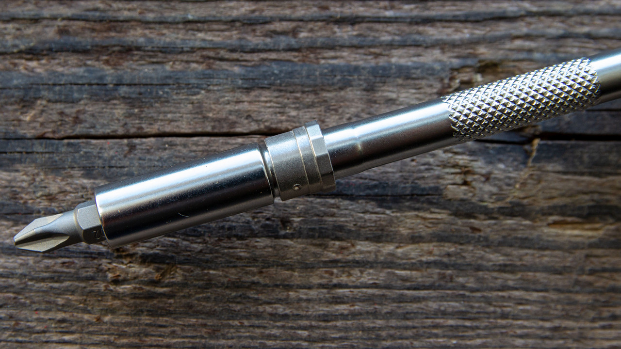

Greetings guys,
I don't know if it's just me. When I'm using screwdriver with swappable bits, those bits tend to fall out of the screwdriver shank when applied too much torque.
I know there are screwdrivers with bit chuck(quick release) equipped. But more are regular screwdrivers.
Just curious if people have the same problem.
Thanks!

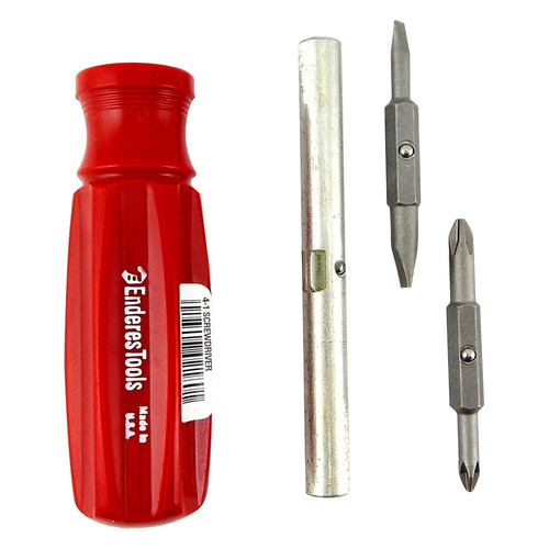

Why do they fall out? Has the ball under the retaining spring gone AWOL?
No amount of torque should cause the bit to fall out (rather the opposite, since torque increases friction between the bit and driver).

The Stanley one that I'm using is a magnetic one.
The bits stuck on the screw, especially hex and torx screws. I guess there's a little deformation on the screw when applied some torque, which made the friction between bits and the screw greater than screwdriver's magnetic holding power. If that makes sense.

Makes perfect sense (and that happens to me too). Was just wondering if there was some other obvious problem.
I don’t have a neat solution, but what I do to prevent this is to gently turn the screwdriver the other way (not hard enough to reverse the screw), which frees the bit from the deformed screw before removing the tool. Doesn’t work well with a ratcheting screwdriver because you have to reverse the ratchet first and it all gets a bit slow and fiddly.

Yes the the retaining spring clip on mine got caught on something and lifted enough for the ball to fall out. I need to know what size ball to buy.

when you're done tightening the fastener, pull the handle lightly perpendicular to the shaft to break the bit free from the Phillips/torx/hex/whatever head before you try to pull it back and this problem will go away forever. It doesn't take much.

I guess I posted a too tough of a question for this kind of forum.
Post your photos and question again in a new post at the end of this thread. Typical readers are far too lazy to scroll back to your edited post. Even after I mention this, most will not go looking for it. Instead they’ll click on the next thread that makes for easier entertainment. Make it easy for people.
Someone is bound to know the correct ball size (ball bearing) to get or have a good guess to try.

7/64 drill bit fits the hole so the bearing should be the next size up? 1/8?
Who sells one or two little ball bearings???
