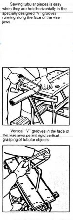

Why the groove in the jaws and the little v's cut into them? By any chance did you find dimensions for making new jaws somewhere online?
It matches the original jaws.
