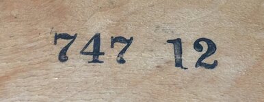

Can you find the production code (the 651 12) stamped on the box anywhere? It would usually be on the top, but I can't see it there in the photos. It would be small and faded so require careful scrutiny.

Love your website. As requested, below are pics of the date printed on the box and the flip side of the warranty card. You are welcome to use the photos for your site. There are no scratch guards, and no marks where they should have been.
Thanks. One more question—What are the bushings at the pivot points of the H-frames made of, steel or white plastic? I can't tell from the photograph.

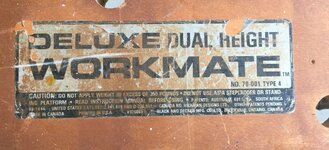

Sometimes when it rains it pours. After finding my first early B&D aluminum workmate last week I thought I had found another today on CL. This afternoon I checked the estate/garage sales on CL and saw one that had started at 8am. Headed that way hoping the B&D Workmate they were using to hold their coffee and money box might still be there and for sale. It was still there upon my arrival but the woman said she didn't think her husband wanted sell it. He came out and said he'd sell it. We agree on $20. First, one I've seen that the upper half of the base is aluminum and the lower half is steel. Seems like this is a transitional Workmate. It is marked as a Type 4. It is in pretty good shape but the clips that hold the top and bottom together when it is folded up are bent inward (or backward) such that only one of them will hold and that one is 50-50 at best. Would like to know more about the Type 4 and how to "repair" the clips so it might work again. I'm concerned about the spot weld breaking or the clip snapping off in the middle. Thoughts?

That's definitely a good deal you got. Both the upper and lower parts of the frame on this are steel; only the two H-frames linking them together are cast aluminum. This is true of the 79-001 Type 1 through Type 5. Of all the 79-001's produced, the Type 4 appears to be the second most common, behind the Type 2.
