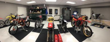

Elsinore13
Sep 20, 2017
504
To the OP, I was reading your post to my wife and as soon as I said black she about lost it. Yes, we own a body shop and yes she knows all the problems associated with black finishes. Apologies for the chuckle at your expense...lol.
You can rest assured though that you probably do have the best looking garage floor in town. It is just going to require a lot of upkeep to keep it clean. I went light gray, no flakes and clear coat with zero grit additive in it so it would be easy to clean and also so it would be easy to find any small parts that may get dropped. It is slick and requires a bit of upkeep itself. I bought a bunch of carpeted rubber mats from Home Depot to put in high traffic area and under all of my projects. I keep a dust mop out there to do a quick buzz around the floor.
