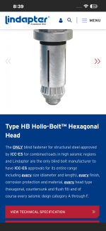

I’m thinking of using 1/2” blind bolts to fasten H-beams to a piece of square metal tubing. Preferably hot dipped galvanized. I will run the answer by the engineer, but I wanted to do some legwork first
What brands should I be looking at? Thanks.

Something like this. I’ve managed to find some, but they all seem to be British for some reason.
This is the top contender so far. Even at 20 bucks a pop, it might be a cleaner install and cheaper than welding.

How is that cheaper or easier than welding?
Don’t know. But wanted to price it out. The stuff is hot dipped. I’m told that that’s a pain in the *** and takes longer.
With the right tool, 30 seconds a hole.
