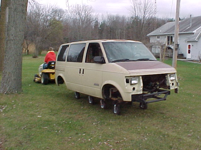

I built one 10 years ago for a '49 F1 I was rebuilding. I used 2 x 6's, 2 x 10's and 10" pneumatic casters. The cab rolled easily and I rebuilt the dolly a few years later to move the body of my Astro van around... I had about 60 bucks into it including the cost of the casters... :)
Reconfigured for the Astro.
I still have it, it's leaned up against the back of the shop, waiting for the next project...
