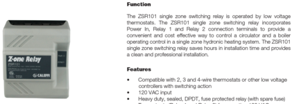

So questions I had right now.
1. I assume these gauges need installed in a sweat manifold like this? Use a tap on the fitting, can't seem to find one that has just 1 sweat fitting though because I just have one gauge for pressure and temp.
2. Finding this fitting would make it cleaner but I can't seem to locate it?
3. Would this zone controller work for this application? I assume I would have to have 2 relays, 1 for each pump?
4. For the low point drains and high point vent I could add the below in green?

The boiler should control its own pump and will have one additional zone built in, so you won’t need the add-on zone controller.
Lets call your “loop 1” the primary loop and “loop 2” the secondary.
The manifolds I used have a thermometer built in. If you haven’t yet purchased a manifold, get one with temperature indication AND purge/vent spigots. You don’t need a pressure gauge or a pressure relief valve on the secondary loop.
Get the pump flange units with the block valve AND the purge valve/spigot and maybe you won’t have to add a bunch of extra vents and drains.
Pump rotors are installed horizontally.
Jackfre
Dec 26, 2010
4,422
N CA
Due they have auxiliary contacts for the pumps/controller?
Some do! Again, that is the research requirement in selecting the right boiler for the system. The boiler manuf are always chasing the features to add to a product to make it more salable and the control features can get pretty crazy.
