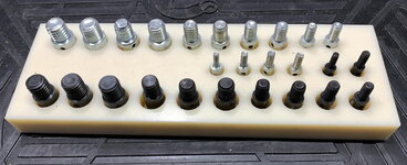

Since discovering these thread gauge "discs" I've been very happy with them.

After you get some nuts & bolts sorted into containers by size you will have an easier time proving the unknowns by laying the bolt threads together, or threading the nut on a bolt. (Hint: re-use containers from your recycling waste.)
Its daunting at the beginning, but it gets easier.

I have that same set and they are very handy. SAE I can tell just by looking at them but struggle a bit with metric when it comes to course vs fine. When you've handled tens of thousands of screws/bolts it gets much easier.

I like to have my nut and bolt gauge on a shelf slightly lower than eye level, in a configuration where i can check items with just one hand.
And mine has metric all on left, SAE all on right. Also has length scales at bottom. Beats looking for a ruler or tape measure.

I use this all the time. It hangs from a hook on my pegboard. With so much recent downtime, I've been catching up on busywork. I've gone thru lots of bolts, screws, and nuts and sorted them by pitch and size to save me from rooting thru a "hell box".
