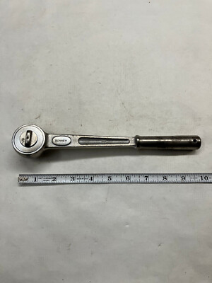

Anyone know where this style ratchet belongs in Bonney history ?
All I know is that it's before the Rozmus patent (1966).
From 59 to 61 there were a couple of patents ( by Hare ) using those stamped cover plates. If it was after them and before Rozmus then they went through 3 ratchet designs in 8 yrs.
I've seen some pre 1959 ads and the drive tools all have knurled handles.
So I'm wondering when these things date too.
The guts come out as one unit and are held in with a snap ring. The pawl is a single piece of rectangular metal and slides side to side in a groove.

At only 36 teeth it's kinda course for a round head. Spring is stiff too but you never know... There may arise some weird situation where it will work nicely.

Anyway, the pawl is different than an sk. It doesn't pivot, just slides back n forth.
Edit: here's a pic of the guts removed. The pawl doesn't even have teeth or a step in it, just a chunk of steel.

I have an older Walden ratcheting adapter that had a sliding pawl similar to that. Monster slab of steel resting on a platform. not the smoothest action, or easy to reverse, but freaking bulletproof. Sorry no internal pics.

Gany, I'm thinking early-mid 1950's, as that coincides with the streamlined wrench style that AA discusses at some length. The 1960 Hare patent ratchet - applied for in 1957 (bottom of the pic) - has the simpler outline design pattern which came after the streamlined. The ratchet at the top of the pic is a V700, which I'm making an edu-macated guess came just before the three 701 series ratchets below it, in the very early 50's.
The three-set of 701's (A701, T701, & V701) and the "oddball" V701 1/4" with the chromed knurled grip are all the same gut design as yours. I'm gonna make another guess that the single bar on yours and my "oddball" was a variation/improvement - those 4 little short ones are harder to grasp and turn/switch with fingertips than the larger single bar.

I thought the same thing when I saw inside this ratchet, that lack of strength is not the reason they stopped making that design.
They just had to keep making finer tooth ratchets to stay ahead.
Blackhawk and Duro also had sliding pawl designs.
I think they were from the 50's too.

Mid 50"s sounds good to me.
