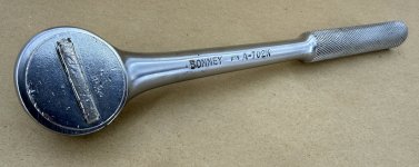

Well, if we're going to post pics of Bonney rats...
A-702K 1/2" modern
A707 1/2" sweetheart style
50's era 3/8" flex with quad wing selector
T-702K 3/8" early style
V-702K 1/4" modern style
A-702K 1/2" modern
That flex ratchet is awesome. I've never seen one of those.
