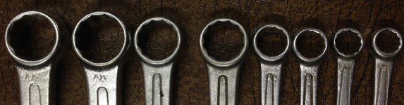

These two metric Outline combo wrenches show how USA was dropped, and replaced with a size stamp to be read when the wrench is laid horizontal. I think the other size stamp, oriented to be read when the wrench is hung from a hook, was introduced when Outline replaced Streamline, though the date codes are pretty much obliterated by the stamped outline motif on each wrench. (hoping more examples can shed some light)

All of these metric combo wrenches have an X code.
Could be the forging was done in 1960, and the stamping later. It further seems obvious to me that tools would have been produced before they could be illustrated in catalogs, and that they could also have been sold (for two years?) before the catalog dates. If Bonney was trying to sell down existing stock, it would make sense to delay national advertizing of a new design until old stock was depleted and sufficient new stock had been manufatured.

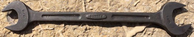

I found this one a few weeks ago. NOS, and coated in cosmoline. Military contract wrench maybe? Definitely not chrome plated. Dated L.O.
